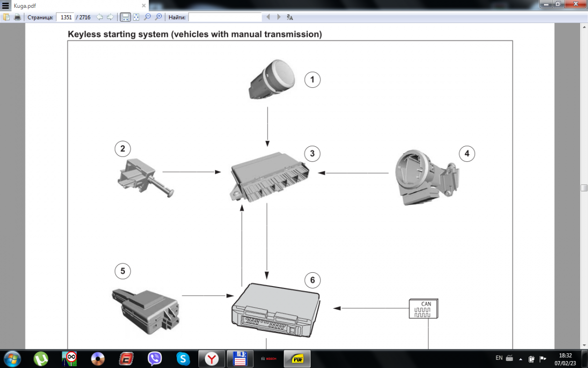

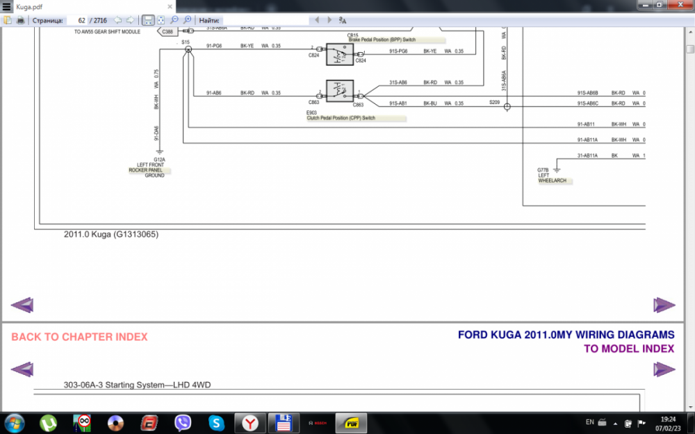

doc.oleg Опубликовано 7 февраля, 2023 Поделиться Опубликовано 7 февраля, 2023 2 часа назад, odin0406 сказал: . какие еще условия ему нужны для включения стартера? System Operation Smart Start The PCM enables the starting process when a key providing a valid code is read via the PATS. This code is then verified in the GEM and compared with the saved code. If this code is recognized as correct, synchronization with other modules is carried out. After successful synchronization, the engine is cleared to start in the PCM. The PCM connects earth to the starter relay, which then connects power to the starter solenoid. As soon as the engine reaches a certain speed, the PCM disconnects the starter relay and so turns off the starter. This protects the starter. If the engine does not turn or turns only slowly, the starting process is aborted by the PCM. The starter is not activated if: • the engine is running (i.e. the engine speed is above a particular value), • the PATS does not permit the engine to be started, • the clutch pedal is not operated (vehicles with manual transmission), • the gear selector level is not set to P or N (vehicles with automatic transmission), • the brake pedal is not operated (vehicles with automatic transmission). Emergency starting function If the keyless vehicle system is unable to recognize the passive key, the vehicle can be started via the emergency starting function. Ссылка на комментарий Поделиться на другие сайты Поделиться

doc.oleg Опубликовано 7 февраля, 2023 Поделиться Опубликовано 7 февраля, 2023 (изменено) Изменено 7 февраля, 2023 пользователем doc.oleg Ссылка на комментарий Поделиться на другие сайты Поделиться
