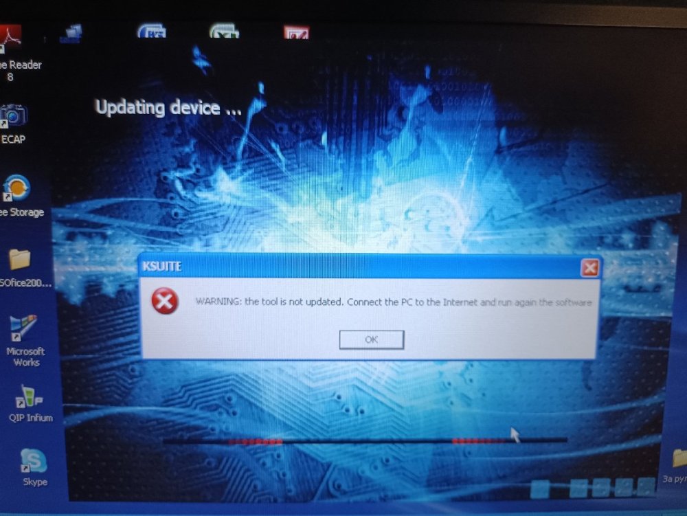

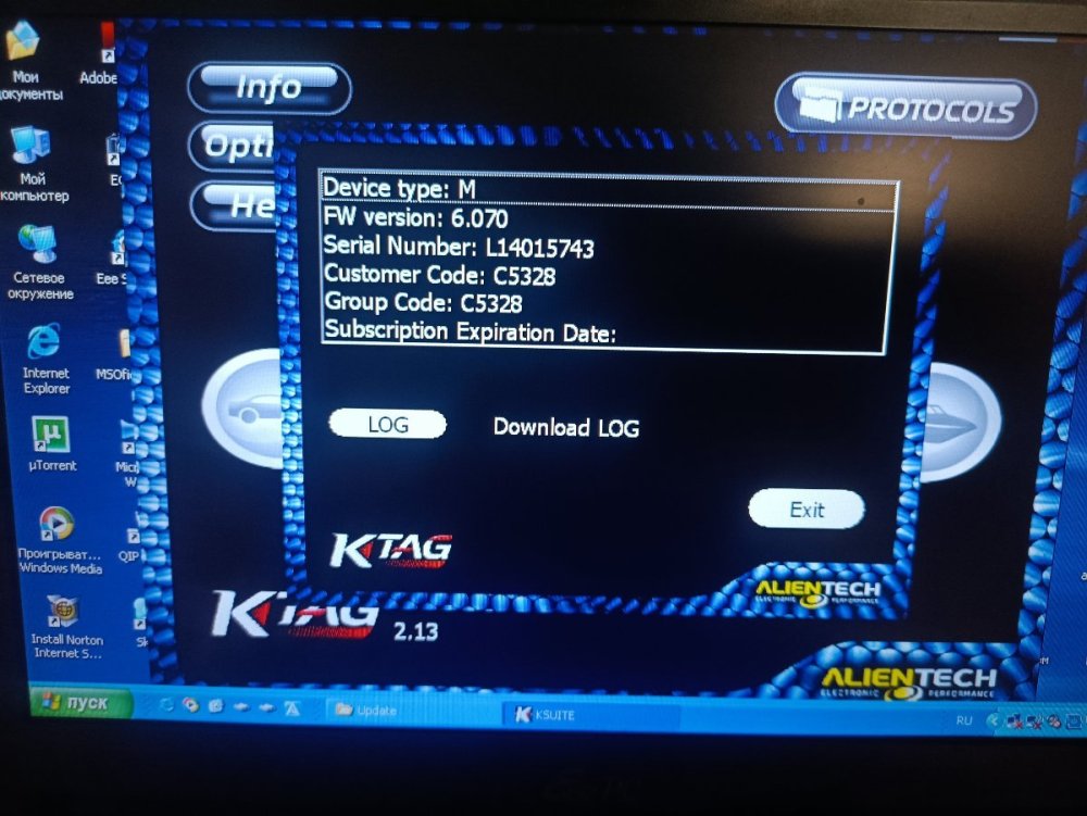

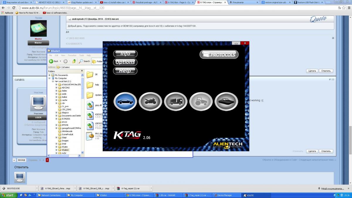

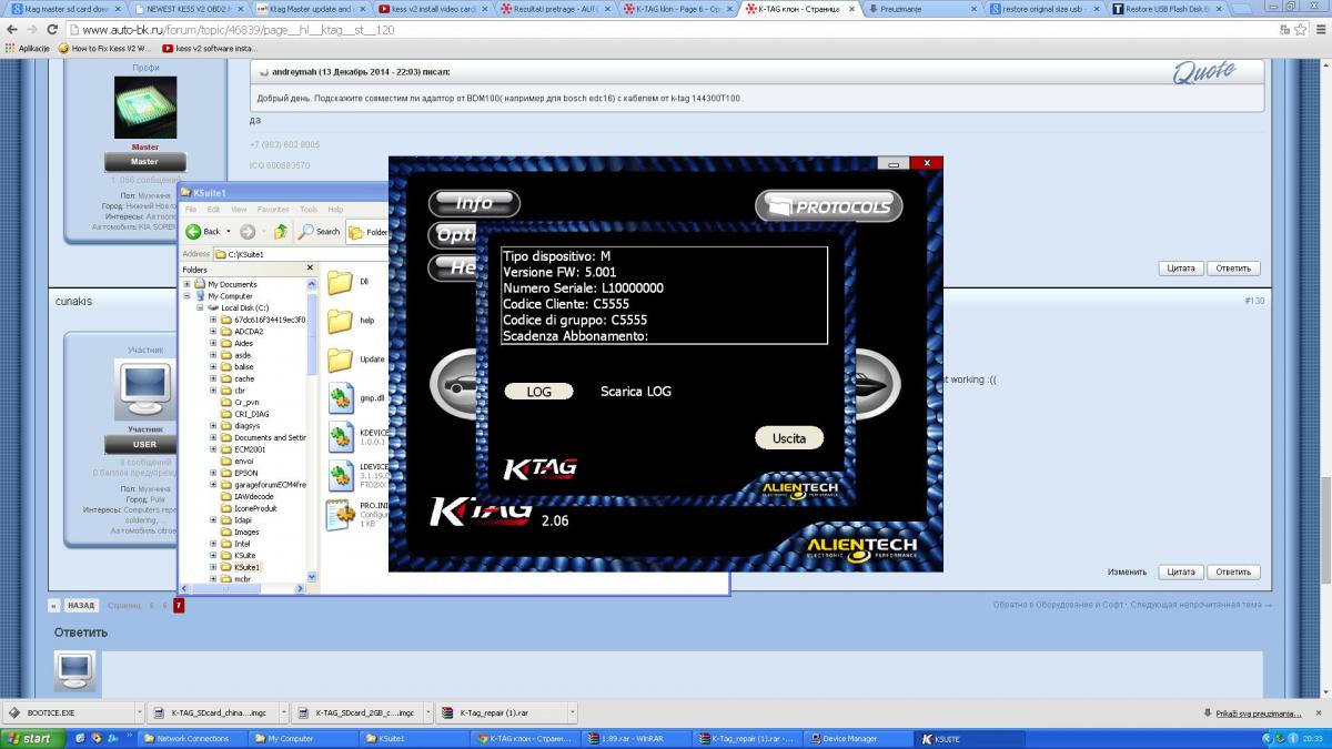

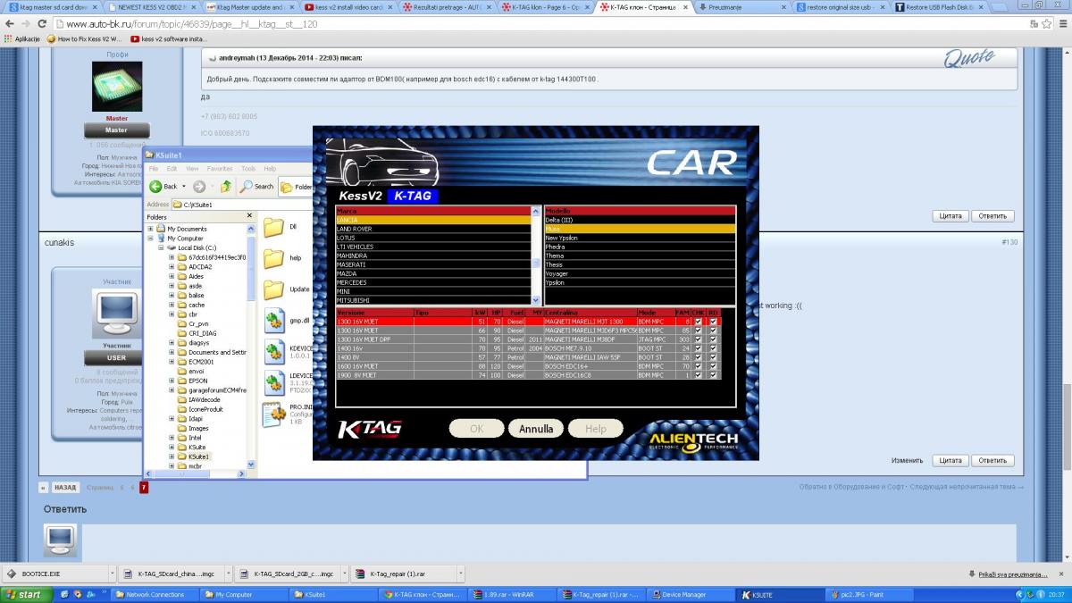

cunakis Опубликовано 14 декабря, 2014 Поделиться Опубликовано 14 декабря, 2014 Hello friends !! My china clone ktag do not working from first day i buy it. Ok button is always greyed so no mather wich ecu i select i cannot press ok because is grayed and not working :(( Maybe some off you have the same problem like me ? One more great device from china :( Maybe somme advice from here ?? Here are some pics of version and how i cannot select ok button . Maybe some of you can help me !! thank you ! Ссылка на комментарий Поделиться на другие сайты Поделиться
wetalj Опубликовано 17 декабря, 2014 Поделиться Опубликовано 17 декабря, 2014 В 14.12.2014 в 20:12, cunakis сказал: Hello friends !! My china clone ktag do not working from first day i buy it. Ok button is always greyed so no mather wich ecu i select i cannot press ok because is grayed and not working :(( Maybe some off you have the same problem like me ? One more great device from china :( Maybe somme advice from here ?? Here are some pics of version and how i cannot select ok button . Maybe some of you can help me !! thank you ! Hi) Install the version 1.89, if you proc don't zalocheny, with firmware 5.001 everything will work. If you connect to the Internet the computer during operation, immediately pipets your device))) Ссылка на комментарий Поделиться на другие сайты Поделиться
cunakis Опубликовано 18 декабря, 2014 Поделиться Опубликовано 18 декабря, 2014 i try, is the same :( Ссылка на комментарий Поделиться на другие сайты Поделиться

cunakis Опубликовано 24 декабря, 2014 Поделиться Опубликовано 24 декабря, 2014 Hello !! just to say about my kessv2 and ktag china clone ,,,,,, after reflashing devices with jlink both devices now working, bu there is still ecu thet is greyed out ! by your expirience what you think about this ? is there a way to add this missing protocols or there is a hardvare problems for this ecu ?? thank you !! Ссылка на комментарий Поделиться на другие сайты Поделиться
