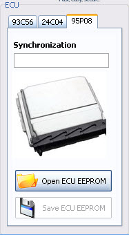

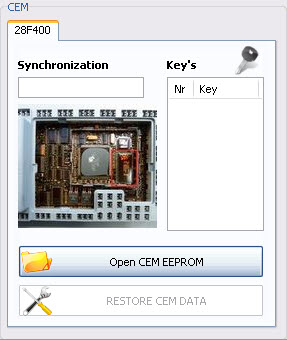

052 Опубликовано 12 ноября, 2015 Поделиться Опубликовано 12 ноября, 2015 (изменено) - replace motor ECU: For repair remove CEM from car, read 28F400 memory with programmer (for ex. ELNEC BEEPROG or other). Remove and open motor ECU and read internal EEPROM memory with CarProg (depending from ECU 93C56, 24C04 or 95P08: in the most cases there is no need to desolder - use A6 adapter). Now open with program CEM and motor ECU files. In CEM immobilizer data you will see keys data, synchronization bytes. Now synchronize CEM with motor ECU by transferring synchro bytes to ECU memory. Now save both files. Motor ECU memory you can write back to EEPROM and install ECU back to the car. Solder original 28F400 (without program modifications) chip to CEM and install CEM back Изменено 12 ноября, 2015 пользователем 052 Ссылка на комментарий Поделиться на другие сайты Поделиться
